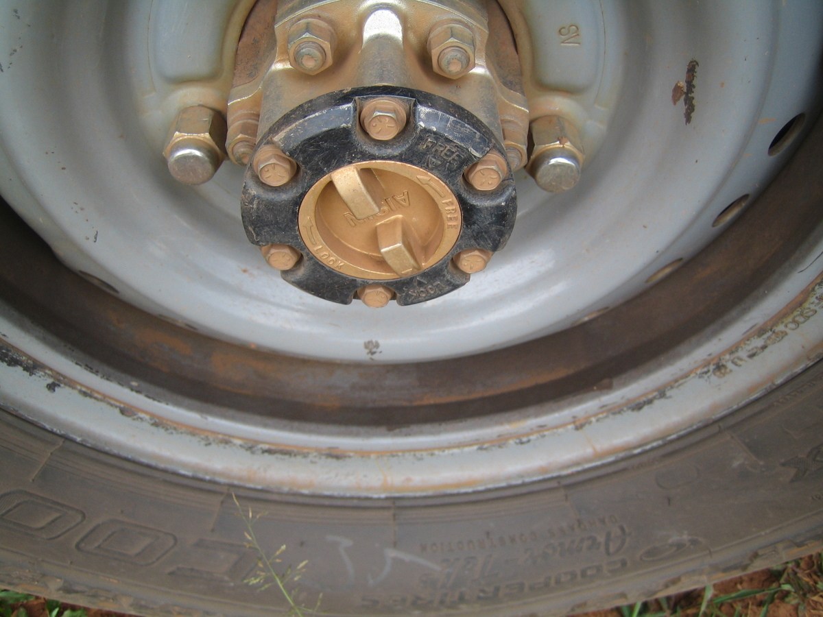

Freewheeling hubs are something I would be interested in but haven't heard or read anything yet? I suspect an aftermarket supplier, which would be a wait.
And for what it's worth 17" plus KO2 which I have on my Series 2 are not just brilliant but it seems to balance the car aesthetically and from the images and look of the prototype, I agree with DaveB, it looks right for the vehicle.
I guess free wheeling hubs wouldn’t be much good in a vehicle with permanent four wheel drive. I’ve only seen them on vehicles with selectable 4 or 2 wheel drive, such as my old hilux
I might have the wrong idea but my take on the centre diff lock is engaging the front end, yes it is always turning but not driven until engaged...any thoughts? If it is the case then free-wheeling hubs would just stop all the unnecessary wear while not engaged...happy motoring
Yep, you got it wrong. The IG is constant 4WD, the centre diff allows the front and rear axles to rotate at different speeds for cornering. The centre diff lock, when engaged, keeps both axles at the same speed.
On a permanent four wheel drive the front and rear axles are permanently engaged via the centre differential, The centre diff lock ensures the same power goes to both axles in the event of one wheel lifting off the ground . During normal road use the centre diff lock is left dis engaged so that front and back axles can turn at different speeds for cornering. Free wheeling hubs are only used on selectable four wheel drive vehicles such as Toyota pick ups and old series Landrover that have no centre differential.
hope this helps and that I haven’t got it wrong 🤔
