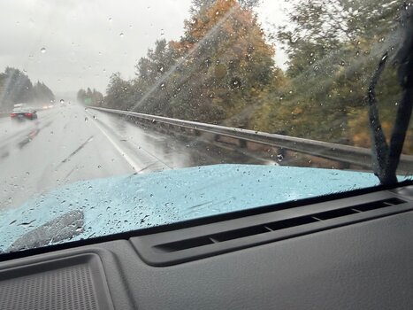

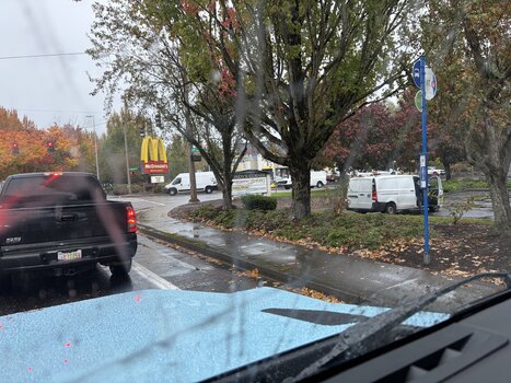

I have windshield protection and replaced OEM with Bosch Evolution. First long drive today in the rain and the wipers were practically unusable. Left smudges all over the windshield. This is a big problem since in live in the rainy PNW. I will try the clay and other things suggested upthread, but am concerned this will be a long term problem.
Rain season is here isn't it. So here is what I did, Windshield defense screen protector. I put on the Bosch 16a wipers. Yes it does work with the QM and I installed them myself. Cost me an old fashion. Then I bought Rain -X plastic. This is different formula compared to regular rain x. The plastic is designed for Googles and motorcycle visors. I coat the window with spray once a month. I fill the washer bottle, with rain x. It has been magic. You can tell when I need to reapply on the window as I will get chattering from my wipers. Good luck
