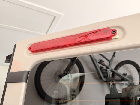

Third brake light has some condensation in it. Looking at replacing it, as it is slowly losing function. Will stay on for a couple of seconds while braking and then shut off with a loud zapping noise. Anyone know how to go about pulling the original off? I pulled the plastic cover from the interior rear door and there aren't any screws from the inside. Is this just adhesive mount? Any help is appreciated.

Was able to get the two black covers off with a plastic trim removal tool. Just pry the covers away from the door. Remove two hex bolts. Unplug the wiring harness located under the interior plastic trim behind the door. Only needed to remove partial trim to access harness. Took about 5 mins overall. Thanks for additional info.

So that was it? Two plastics and screws… the rest was plug and play with the new light?
