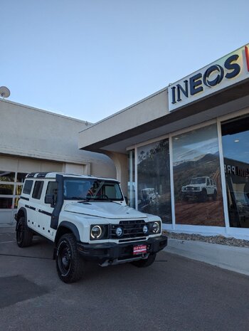

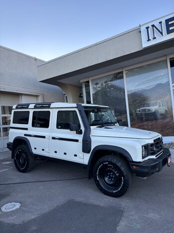

Couple photos of the day I brought it home back in September 2024.

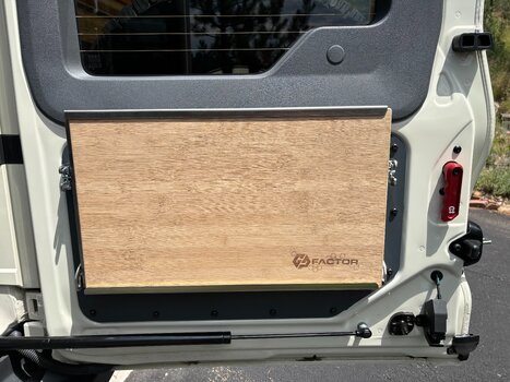

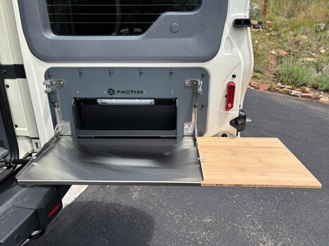

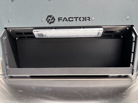

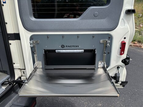

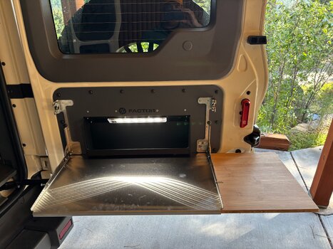

GP Factor Drop Down Table
This version has the cubby space behind the drop down table for small items. There is also a National Luna LED light. It has a button on the fixture to turn it on/off, change from white to red color, and also has a few stages to dim how bright it is. Solid upgrade and would highly recommend.

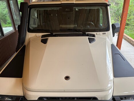

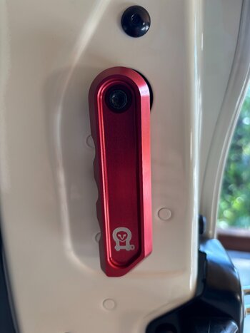

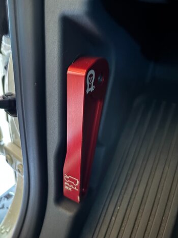

OWL Hood Release & OWL Rear Door Handle
I know the usefulness of this "upgrade" is debated but I have been super happy with it. It was a tactile enhancement for me as I thought the stock handles felt cheap for a vehicle of this caliber. Every time I grab the rear door handle it just feels nice and reminded of how much I enjoy this simple little improvement.

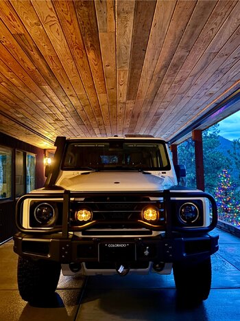

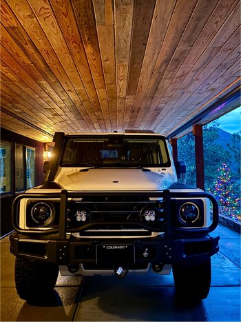

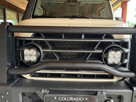

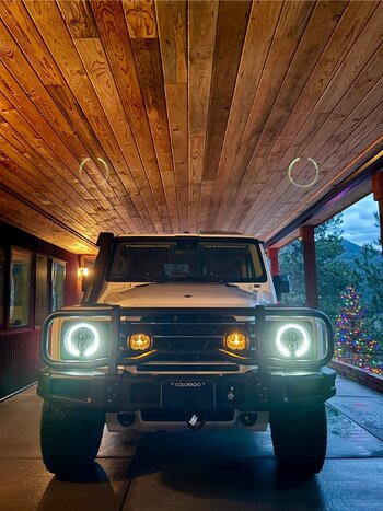

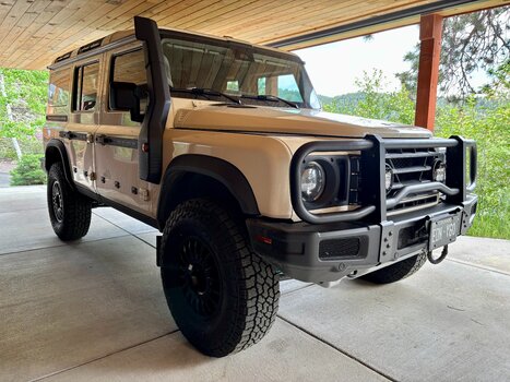

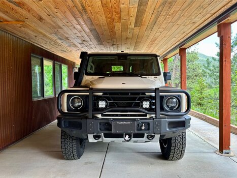

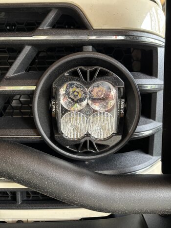

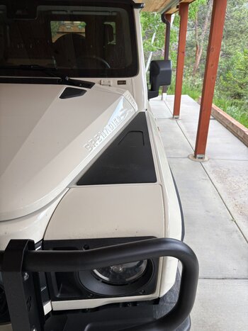

GP Factor Bull Bar
OWL Light Brackets
Baja Designs LP4's
GP Factor bull bar was a great addition and super simple install.

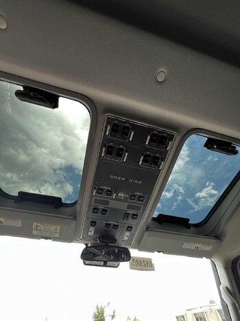

I am also quite pleased with the final result of the installation of the owl light brackets and the Baja Designs LP4 fixtures that replace the factory aux lamps. The brackets required a bit of "fiddling" to get them installed but once they are in, they are nice and solid. The low amperage back light portion of the LP4's is controlled on Aux Switch 1 in my overhead panel. I'll have to get photos, but combined with the parking lights it makes the front end looks pretty sharp. Then the higher amperage draw of the light being fully ON is controlled on Aux Switch 5 in my overhead panel. They are incredibly bright, don't bounce around, and is very convenient to be able to turn either option on/off so quickly and easily and/or without having to use my high beams. Really glad to have ditched the stock light fixtures.

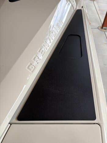

GP Factor Checker Plates
Spend the time cleaning the surface before application. And also allow the VHB cure above 70 degrees with some weight applied on top of the plate for at least 24 hours. Have been on the truck for 6 months are are still rock solid!

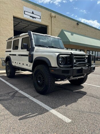

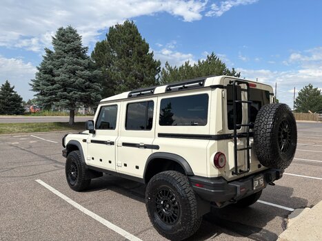

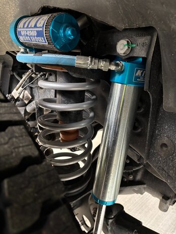

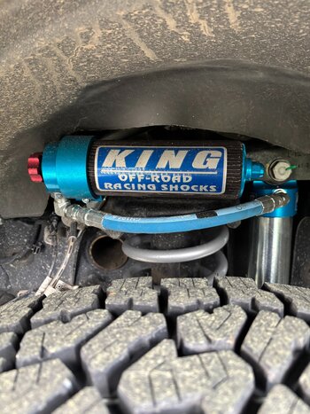

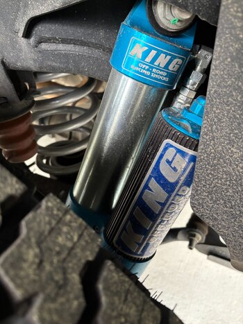

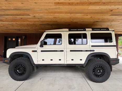

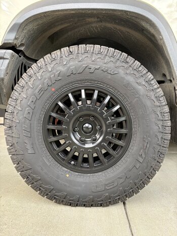

Suspension
  • Ebiach Springs 1.2” rear, 1.7” front
  • King Shocks
  • King Steering Stabilizer

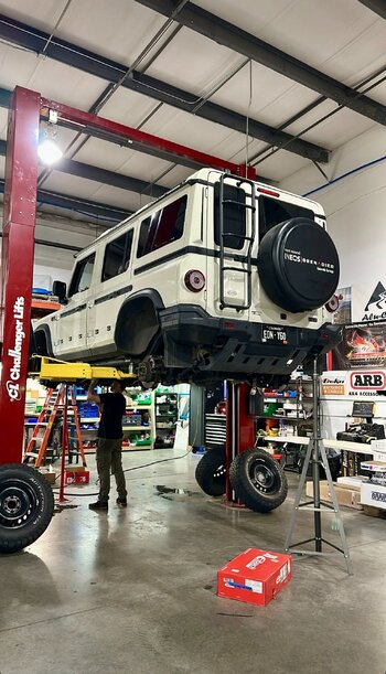

The improved stance along with the 35" tires really make this thing look great. It feels proportional without getting carried away - same way I feel about the AEV trucks. It definitely drives better than the stock suspension which I thought was pretty harsh over bumps or pot holes around town. I love the ride of kings - have them on several vehicles. I have about 4k miles under my belt with this current set up. Haven't needed to do the front driveshaft boot yet but expect that will be a given in the near future.
I would say that a suspension upgrade like this will also exacerbate certain characteristics while you are getting familiar with how it drives. I read a long while back in this forum that someone felt that the suspension upgrade they completed made the "sway" or body roll feel even worse. And I would somewhat agree with that, but only for the first few drives as you're getting to know the new suspension. First few drives out when you hit a corner at speed you'll notice the same body roll as before but almost feels like it continues rolling. Because I didn't know that "sweet spot" for where to expect the body roll to settle during a sharp turn I found myself letting off the accelerator or adjusting my steering - but it was just a learning curve. Once I figured out what to expect and it became second nature I find that I drive it no different that I did stock, and is just a better ride now.

Suspension
  • King Shocks
That does look good on those talker tyres. 😍
Looks really good. Can you provide the deets on the tires? Are those E rated? What size are they with all three numbers please. Are they wider than stock? What psi are you running in them. What pressure are the kings set to?
I'm thinking about the same combo. Too bad they don't offer a small discount to buy them together.
