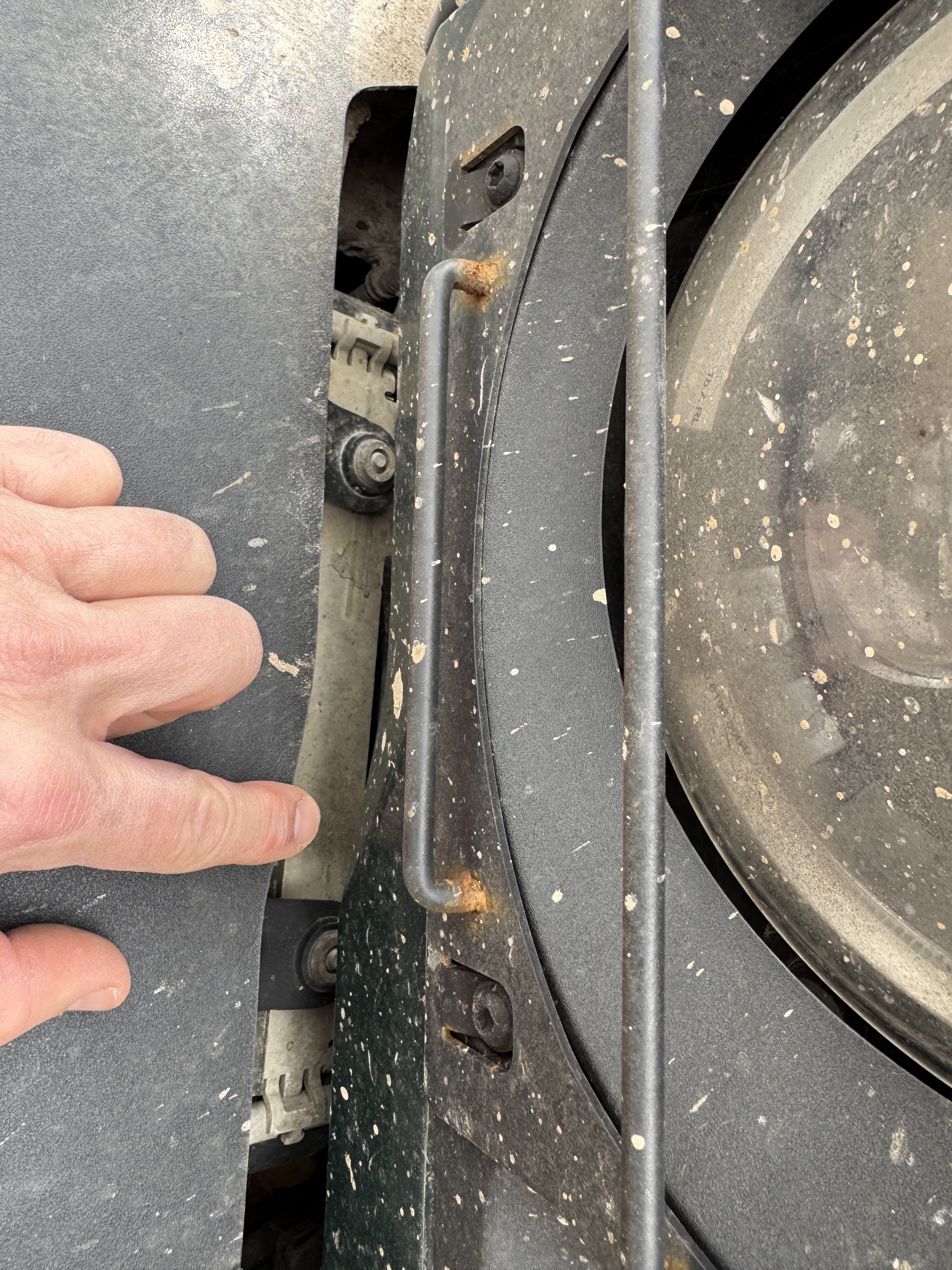

Said rhs small radiator (drivers right hand drive).
Is this the 'missing bracket.
Excuse the rusty lamp
protectors - Aliexpress specials!!
The sprung steel brackets are on African spec vehicles that I saw but that maybe just the newest iterations. I had theses brackets added to mine in Namibia after small rads fell out of their fixings many times. The brackets/support bars stop the lower part of the steel bumper that is underneath the plastic outer bumper from flexing on extremely rough or corrugated roads.
If you have the parts looks an easy retrofit, probably not tricky to fabricate.

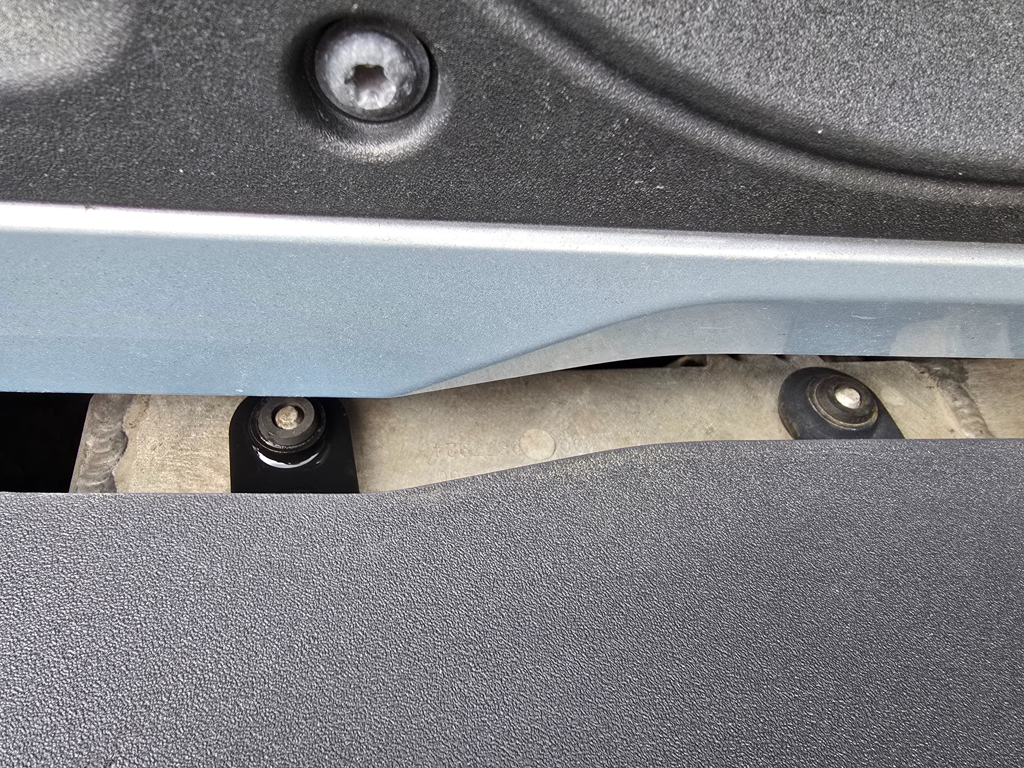

Mine is an early UK vehicle, I looks as though 1 side has had a new bracket and the other has had 2 when it's been in for work/service's
That's odd. Wonder of just different finishes at build? Did the garage confirm work done on them when went in?
There has been a number of different updates done but I couldn't say what. 3 of them are definitely newer than the 4th and from your picture I do seem to have an extra bracket which does suggest they are aware if the issue and fixing it. If it's not done on anyone else's it's probably worth asking about
