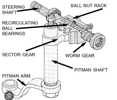

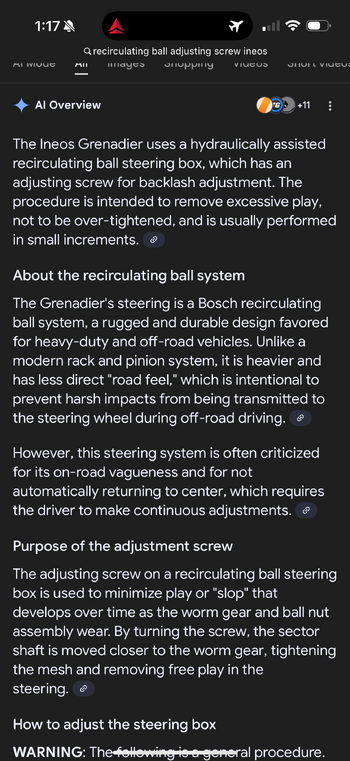

Is this just AI not being accurate? I don’t see an adjustment screw
In that image the adjustment is on the top of the sector shaft. That particular box has a gear lash adjustment. But if the slip is in the ball section there is not much that can be done. It's possible our boxes use shims rather than an adjustable screw/nut. I'd be happy to rework a box, but the core would either be unobtaniom or shockingly expensive.
