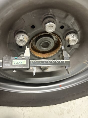

Can anyone confirm that the sprinter van wheel hub flange is the same diameter as the Grenadier. I want to keep the steelies but want to utilize a slip over hub spacer that rides over the hub like what OWL has for the sprinter vans. Its a much safer option than a bolt on spacer. I dont want much extra width, would just like them to be not so tucked.

The Grenadier hub pilot diameter is 130mm. The newer Sprinter vans (VS30) use a 120mm hub. They are not the same.
You cannot use a Sprinter-specific hub-centric spacer on a Grenadier. You will need to find a spacer specifically made for the Grenadier's 130mm hub and 6x130 bolt pattern.

Yes, the 6-lug Sprinter wheel has the same hub diameter and bolt pattern. It is 6.5" wide, narrower than the Grenadier's 17" steelies.
You will need 6mm or 1/4" thick spacer to clear the brake calipers - the wheels have deeper offset. You will also need domed (not cone) lug nuts, Porsche style.
