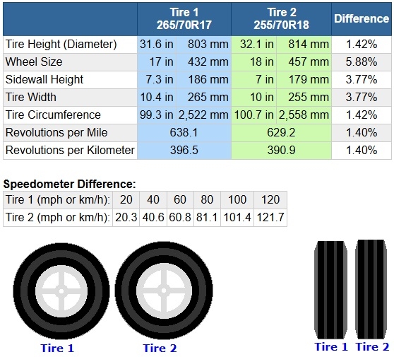

Part of the issue will be due to the KO2 tyre size versus the Bridgestone tyre size, , plus whether you're running 17's or 18's, noting that the Gren's speed reading 'configuration' has to deal with different stock tyre sizes and can therefore never be 'accurate' for all.
Per below, if you are running 18-inch rims with the Bridgestone Duellers, you will get different (and more accurate) readings than if you are running 17-inch wheels with KO2s (as I am).
The comparison table below shows how the 18-inch Dueller is 5.88% larger than the KO2, which translates to a 1.4% deviation in readings on the speedometer. Note that the speedometer difference shown in the table below is indexing the first tyre to the second (i.e. 100 vs 101.4) and is not saying that the first tyre would read 100 at 100mph.
Speedometer 'accuracy' readings for 265/70/17 BFG KO2:
Speedometer 'accuracy' readings for 255/70/18 Bridgestone Dueller:
All of the above also assume that you are running appropriate tyre pressures, as different tyre pressures will directly affect the diameter of a moving vehicle. The laden weight of the vehicle will also impact this.
As mentioned by @ECrider you can solve your differences via a larger tyre size. It feel that it's a little unfair to expect INEOS to have a speedometer that gives the same accuracy for all 'standard' tyres fitted and in all modes of use, given it's many different intended applications.

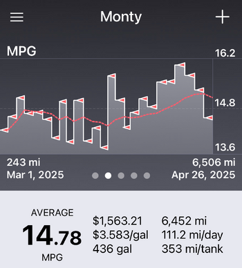

I've got close to 6,500 miles on the truck and have tracked my fuel economy since day 1. The computer has routinely been 3-4 mpg higher. I do find that mileage is better when I use premium fuel, which is all I use now.
