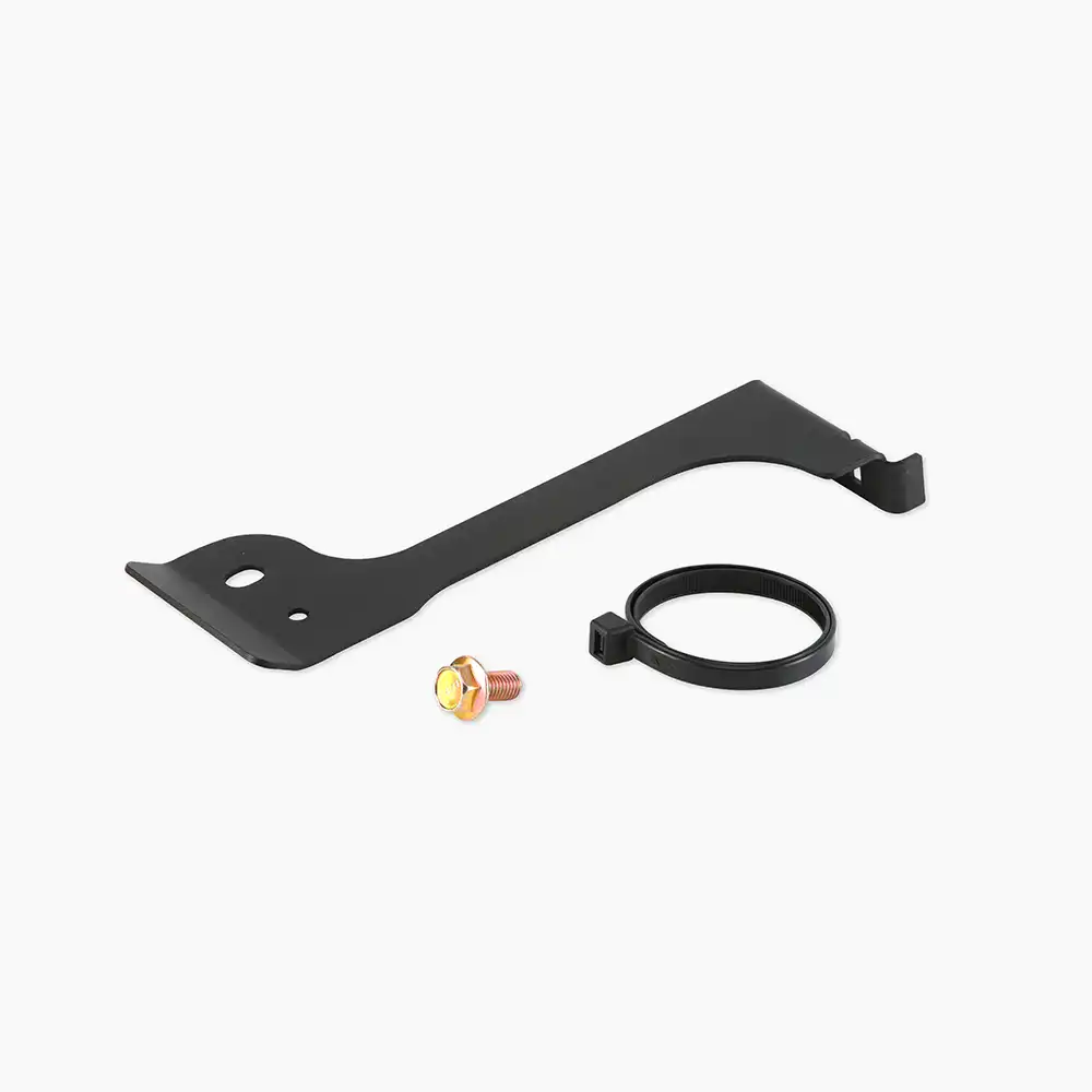

I have the rival skid plate. Put it on well before agile has any option on the market.
I assume it's incompatible with the agile low range shift support bracket since the cross bar from rival doesn't have a spot to mount it to?
No - it still works. The hole it uses isn’t used by the Rival skid plate. I added my AO bracket a week or so ago, no drama (othe than a little fiddle-y to get the wrench turning the bolt (a ratcheting wrench is a.must with the skid plate already in place).
Would you mind sticking your phone up there so I can see where it bolts on to?
I couldn't see where it's bolted and I spent a decent amount of time under my car today to figure it out.
