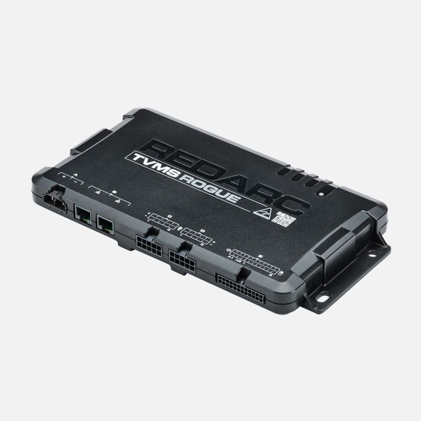

What I'm trying to do is figure out a location to mount the Redarc Rogue TVMS. I purchased a plate bracket from Agile Offroad but it turns out it just replaces the GP Bracket over the center hump and doesn't allow for enough space. I have a Redarc lithium battery installed where the second factory AGM battery was so there seems to be quite a bit of room behind it in the empty space. Looking for any kind of mounting solution someone may have come up with???

The REDARC Rogue does come with its own mounting points. Can they be used to mount onto a flat surface?
I have a 2 seater and they would work for me, I cannot comment on the 5 seater. The challenge maybe a flat position allowing all the wires in and out of the Rogue.
