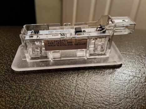

Hi,
Does anyone know what type of electrical connectors are used to plug into the internaL roof lights, especially the one in the rear.
Photos attached of the lamp.
I've emailed the company but just wondered if anyone has been down this road already?
Thanks
G.

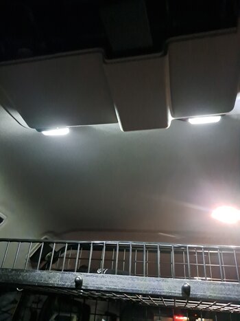

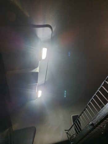

Okay, update, and a couple lessons learnt.
Ended up buying the connectors from A. Bought more than required as still learning, thought there would be causualties along the learning curve. Lights were also A, LED number plate lights.
Made a short infill loom and took a feed from there to two new lights, feed the wires through the space between the roof and head liner popping out at the cover over the rear door latch cover.
Lights are 3m adhered to the back of that cover and wire just looped back in for now.
Connectors - what a PITA they are! Having fingers like sausages and not the best eyesight, not a good mix! Thought DTP were fiddly!
Cover to rear door latch removal - not advised at temperature below zero, managed to snap one of the legs holding the plastic clips, off!
Also manged to blow that circuit somehow and now know the 5 amp fuse also contols the battery level display in the offroad menu.
All back together now and pretty happy with it. Will tidy wiring up later once used a few times.
G.

this is the plug that mates with the light .
Have not ordered it yet but based on part numbers this is the one .
this is the male plug ( same as the light fixture above)
Again not bought them yet , just sitting in my cart untill i have time to do my project
I can confirm the above connectors are the correct ones for getting power from the dome light at the back
