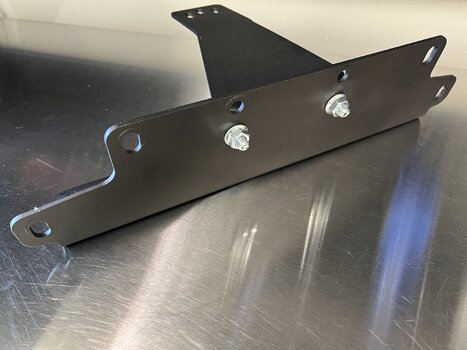

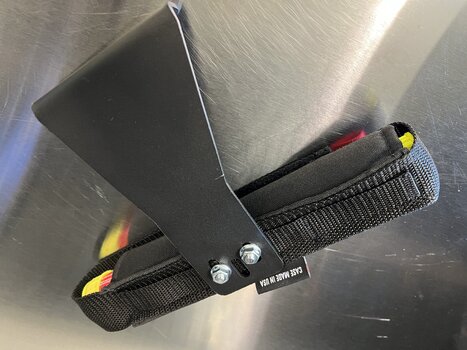

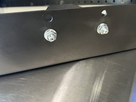

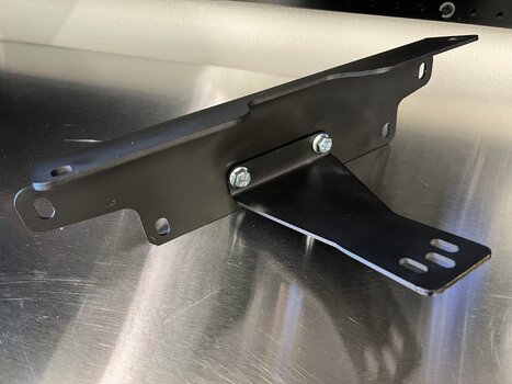

Thought I’d share a quick modification to the Agile Offroad Fire Extinguisher Bracket Kit to fit the Element Fire Stick for a discreet install under the Drivers seat. The Agile bracket did all the heavy lifting but for a more custom fit I drilled a couple of extra holes to raise the bracket slightly to allow clearance for the Element Stick so it would tuck neatly into the molded area of the floor under the seat.
I did cut a little off of the length of the bracket that sticks forward to keep the install as far back under the seat as possible to avoid kicking it with my heels. For those who don’t want the bulk of a metal extinguisher or the thoughts of a pressurized tank behind their legs this might be a good alternative. I included some images below of the install for those who may be interested. I installed the Element E50 stick but I think there is just enough room to fit the larger E100 but certainly measure first.
