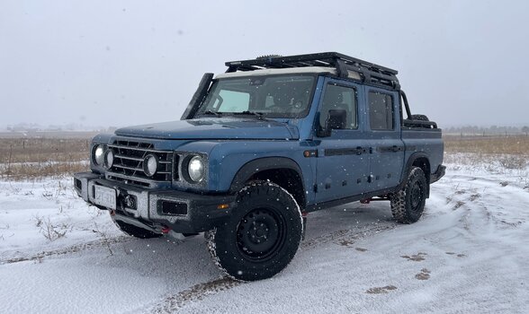

Has anyone tried removing the QUARTERMASTER on the side of the truckbed. Did it leave any residue? Was thinking of just using a heat gun and trying to peel off gently. Any tips appreciated! Just not a huge fan of the look of that decal.

Wait for a hot hot day and they usually come off. Now that’s on other cars, what I don’t know is if there are alignment holes and pins in the letters. On the Gladiator for example it leaves holes in the tailgate. You might want to find out. If no holes than a hot day will work. Followed by either goo gone or WD-40 to remove any residue. Use a new clean microfiber cloth, don’t rub hard if there is residue, it’s new paint and you can leave marks if you’re not careful

Just FYI for anyone looking at doing this. They just peeled right off with my fingernail. Whole process took about 15 minutes, hit it with a little goo-gone and it's like they were never there.

I applied a little heat with a heat gun (Hair Dryer works as well) the decal peeled off straightaway.
A little GooGone to remove any remaining adhesive, then a bit of swirl remover / polishing compound cleaned up any sort of paint variation due to paint oxidation.
I could tell a slight color shift prior to using the paint correction products ( I could see faintly the outline where the decal was applied).
I personally thought the decal cheapened the look of the truck, just my opinion.
