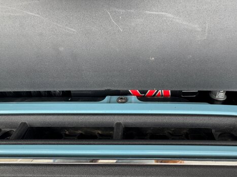

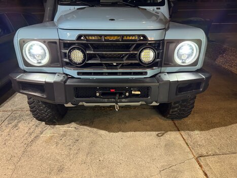

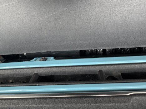

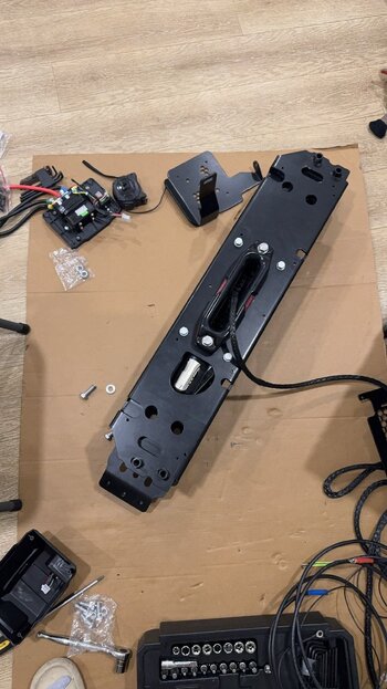

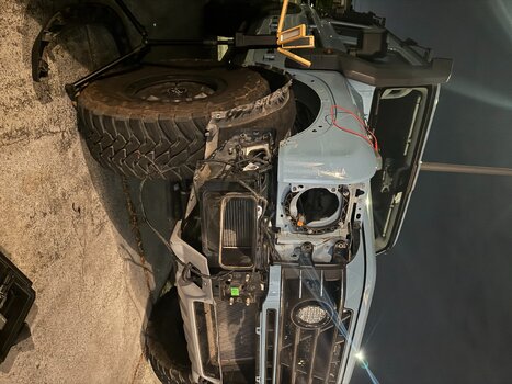

Installing a hidden winch was a brand-new experience for me, and I couldn’t be happier with the end results!
The best part is that there’s now a new player in the market offering a hidden winch kit that works perfectly with my favorite Warn winch.
The kit can work with Warn EVO VR 8,10,12 wich.
What really impressed me:
No cutting or trimming of the original bumper plastics is needed – a true bolt-on solution that keeps the Grenadier’s factory look intact.
Price advantage compared to other vendor, making it a very cost-effective upgrade.
The flexibility to pair it with a Warn winch, so I didn’t have to compromise on performance or reliability.

Can you explain the install and any potential issues doing it? And which winch and line length did you end up using?
I think the only thing needs to mention is the solenoid box need to relocate to the engine bay, and the the line length is 90'. You can use any Warn EVO VR winch.

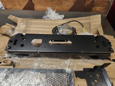

For anyone interested here is how the winch tray from Ramy looked when it arrived.

I should also mention that there is no installation instructions or license plate holder included in the package. The powder coating is also chipping off in several spots. They did include some light gauge cables to extend the control box.

To me it looks like the surface prep prior to powder coating was not done well.
I would request to have that piece sandblasted and powder coated again.

I'm definitely going to have it blasted and coated again, but I'm going to hold off until I decide if I'm going to modify it. I'm not 100% sold on the way the hawse appears to be centered on the drum.
