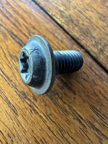

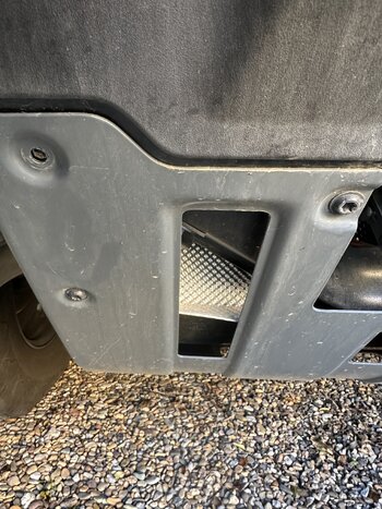

Need help sourcing Torx bolt as per images. Dealer has not been able to. Any assistance would be greatly appreciated.

It does not have to be a Torx head bolt, just a bolt with the same thread pitch and bolt length. Get the dealer to tell you thread pitch, bolt size and bolt length and go to your local Bolt Shop.
It is probably easier to find the same bolt with a different head (like a hex head).

Here in the US I would suggest ordering from Belmetric. They will have virtually the same bolt and finish. With that, I would order a full set for the skid plate so they all fully match.

The combination of Torx drive over Button Flange Head is uncommon here. M8 x 1.25 is common in the likely 15-25mm length you need. If you can accept a different drive type (not Torx) you have plenty of options.

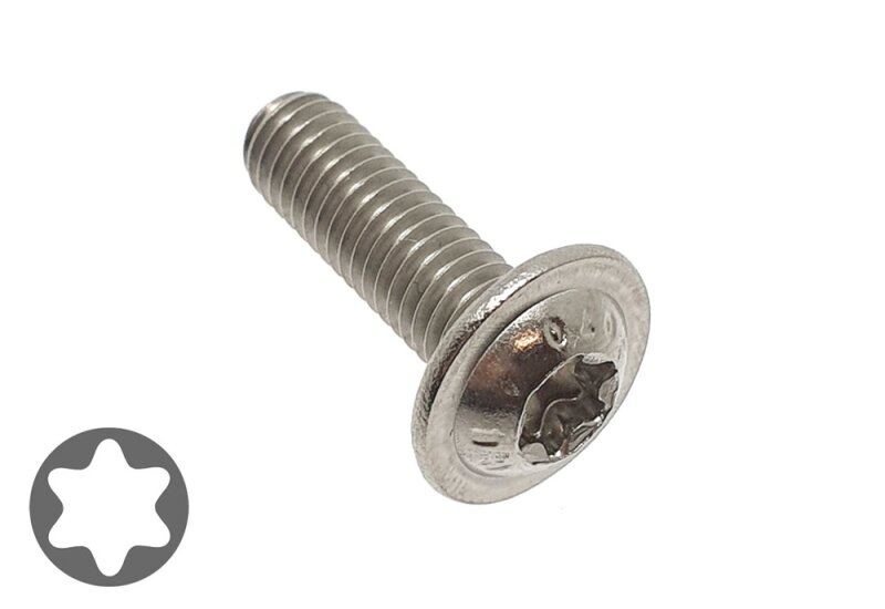

This looks similar - if you can live with an internal hex drive (5mm hex key). Various lengths available. Example only.
