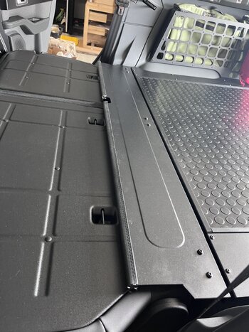

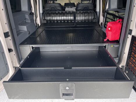

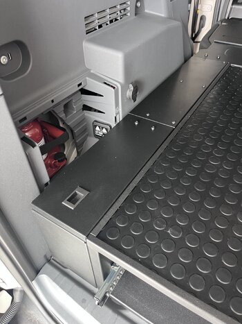

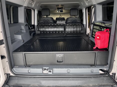

Rear Organization. I went with the bison side boxes (left side still on the way) and table. The upper shelf from Gearmate and the OEM drawer. All the installs were pretty straightforward. The drawer had ZERO instructions but it wasn't too hard to figure out. The drawer is nice and very heavy duty. In hindsight I probably would have ordered direct from gearmate to get the version that still has the L tracks. However this came with a new plastic side trim piece from ineos that moves up the 12v a few inches since the drawer would cover it otherwise. This doesn't exactly sit perfectly level with seats, but it's close. They give you a hinged metal flap to cover the gap, but I might look for another solution. The metal is thin and bends easily.

Great stuff mate! Thanks for showing the photos of the rear section of the drawers matching up to the folded down seats! I have my Magic Mushroom on order with an Inky Black Roof!
