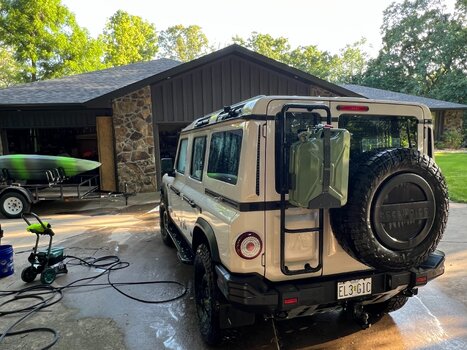

I have seen the LeTech ladder for a single can...and the rotopack options....and the side carry by cargo window that hang off grab handles and lock into utility track on bottom. I am hoping someone comes up with a mount for ladder that holds 2x Jerry Cans side by side. I had this set up on ever FJ60, FJC, and UZJ100...and loved it though they all required a custom bumper to swing off. Since we have a true usable ladder am hoping someone makes a carrier that mounts to ladder that allows two of the military style cans side by side. If they can swing out from ladder for short periods to allow climbing it is a bonus...but not deal breaker. Would be less than 140# total weight with rack am guessing.

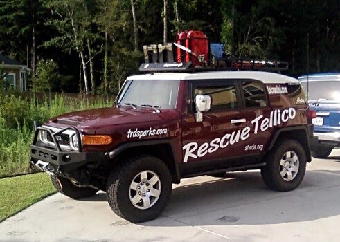

I love that config so I can carry two for fuel or one for fuel and one for water. I typically do the one fuel and one water for camping excursions and when out with my dog hunting or training so I always have water available. When I traveled cross country I like to have two fuel on rack and then put the water in next to dog crate. On my FJC I put them on a roof rack mount system for a while but am trying to do without a roof rack as long as possible since mine is also a daily driver and not sure would be able to get into parking garage at airport with rack on top....especially with any side rails...would have to be platform only and no more than 4 inches above roofline total height at max...haha.
Anyhow, if anyone knows of anyone that has put something together...would appreciate it. Not a fan of carrying in rear hitch mounted cargo carrier as low to ground if rear-ended by someone....the other options will typically be higher than their bumper and hood especially if they are braking to avoid contact and car submarines lower in front....and kisses my tow bar ;).
I prefer the 20L cans and already have a few of them for fuel and water.... thanks again.

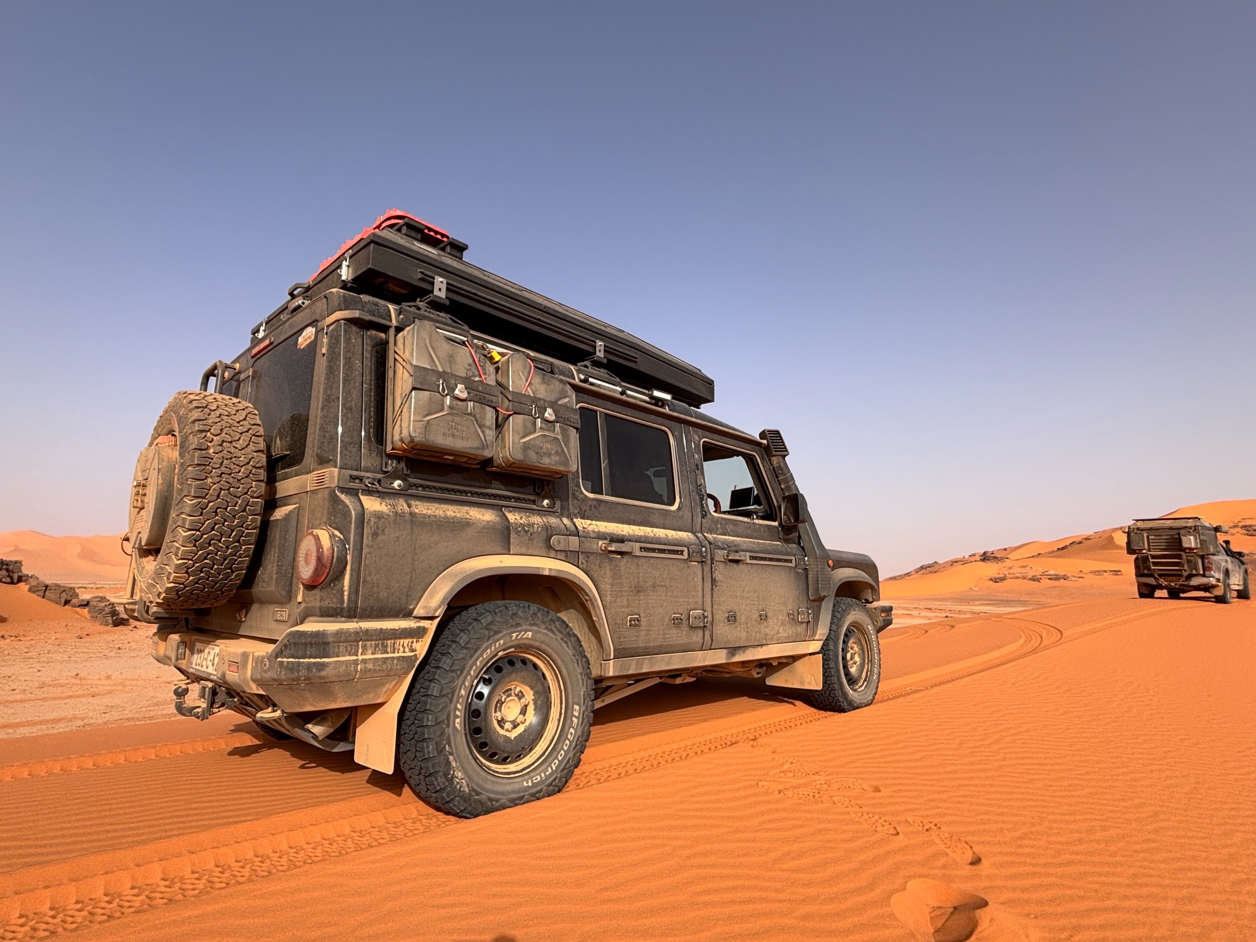

Only fyi on my setup
LeTech ladder with 20L jerry, BlackSheep side carrier with 2x20L jerry and an extra 8.5L circular tank in the spare wheel.

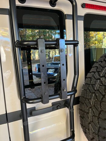

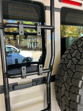

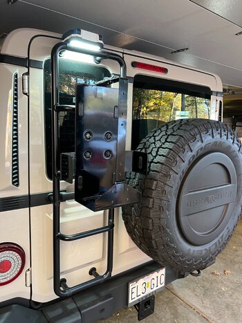

You may have got it figured out by now. This was a real simple install, really no fabrication. I put mine up high so not as big an issue if I get rear ended. I have the Wolfbox, so visibility isnt an issue. I took two 4 bar clamps, (these motorcycle mounting brackets https://www.amazon.com/dp/B09V548LTF?tag=globalgrena0b-20 ) and then bought two pieces of steel 1.5" wide and about 20" long. Drilled 4 holes in each - 2 for the bar clamp and 2 for the jerry can carrier. Took less than an hour, and that includes running to the store for the steel. I am thinking about using a plate and adding a hinge option, but as for now I don't need access to the roof. DVA Mechanics (found out about them after I started in on this) has a system that is pulled a bit away from the ladder, so you can get your foot on the rung.

DVA Mechanics has a good simple solution for the rear ladder. Or you could just bolt on something like this - which I did last year. Not been an issue on any of my trips.

Thanks. Looks good! I ended up ordering the DVA Mechanics maxtrax mount for the ladder, and will relocate my extra water to the rear side(s) with some other solution (still researching).
