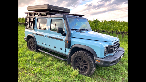

Dear Grenadier friends,
We want to start our trip to Australia from Perth at the end of 2026. The planned duration of the trip is approx. 12 months.
Our Grenadier needs to be made fit for this. To do this, we still need a bull bar, winch, radio, water tank, fuel tank, and possibly a simple trailer. Which company can you recommend to carry out this work?
Best regards, Rolf
Welcome to the forum sorry I’ve got no suggestions for aftermarket outfitters.
