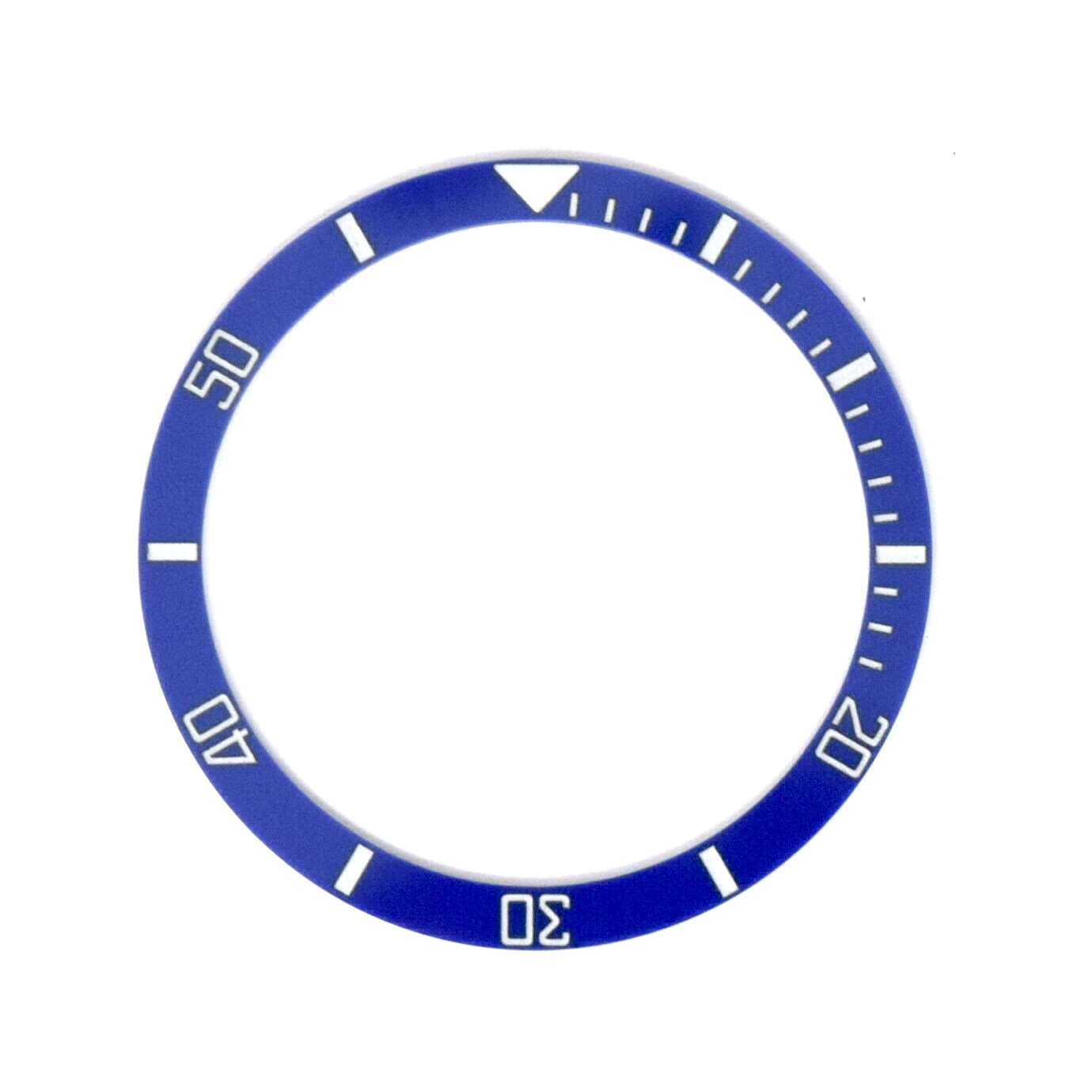

1) Buy a lumed bezel insert like this one, and put it around the ignition hole. I have some of these in a box somewhere of things I still need to unpack from my last move in Nov 2023, but one day I'll test it out. This should at least make it easier to see where the ignition hole is, although the lume won't be bright enough to actually illuminate the key area.

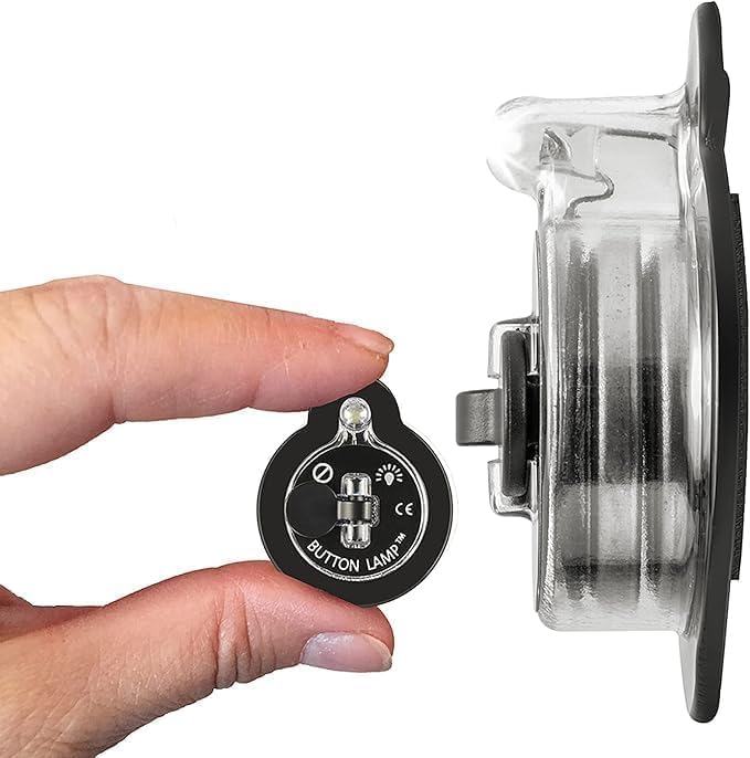

2) Buy a small led light like this one and mount it near the key hole. I think there may be room above the ignition to have this shining down. I ordered a 3 pack of these and will test it out and update this post after they arrive.
Not a major issue but I bought a similar illumination ring on ebay about a year ago for a couple of bucks
Works fine, gets recharged via sunlight. The button lamp might be a bit OTT
I have a glow-in-the-dark ring around my ignition. After more than a year, I've taken to indexing my key and not looking...
The lack of a funnel sucks, but I bet part of my problem is the key being opposite my gwagon.
Just be mindful of the stick on illumination circles. There are a few posts on here that state they are the cause of the car not starting, as the key does not slip all the way in, and immobilizer will not allow car to start. For me, I just use my finger extended to the end of the key, and feel for the hole. Once found, I insert the key in the slot.
