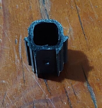

There was a latch......oops
I guess if I continue, the light bar will work but maybe I'll only have one of the original lights.
The joys of diy
Le sigh.....
