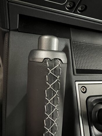

Anyone else having issues with the plastic shroud around the handbrake button fracturing and chipping away? It seems to be happening right where the stitches are in the leather. Subsequently, I looked back at some pictures of my vehicles interior I took at delivery and noticed a small single chip in the shroud which somehow I missed. Another small piece has since chipped away so I suspect the shroud was probably fractured during assembly perhaps?
I did notice a picture on GrenadiersUSA website (maybe they could make an aluminum replacement) showing a similarly chipped shroud so I’m curious if others are experiencing the same?

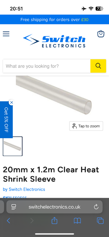

Something like this perhaps? 🤔
1.2 Mts cut into 5mm segments should sort out a lot of brake handle ends, until someone comes up with a nice alloy alternative. Certainly sort out CRH and myself who live close by each other. 😊

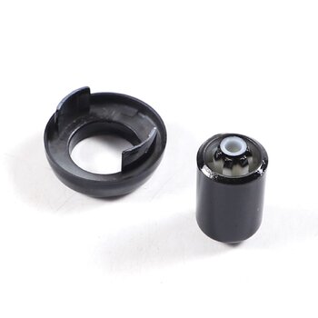

Does the cap/shroud just pull off? Does anyone have a picture of the cap removed from the handle?

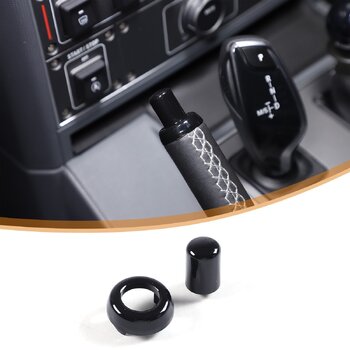

There is an eBay seller offering some sort of plastic replacement in black and maybe a few other colors so I assume the stock button/shroud comes off but how well or durable a replacement would be is anyone’s guess? A simple grey colored replacement similar to the stock unit would be fine but a powder coated aluminum one would be better.

Might be easier to just order one of these Chinesium versions and spray it grey.

The ring is listed separately to the handle. Unless IA haven't provisioned it as a spare part it should be available to order.

The OEM ring is a rubbish part. I think they are programmed to self destruct in 3,2,1...
