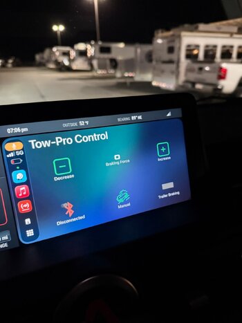

Thanks to our freinds at Redarc we have another option for a brake controler. First one installed and tested. More testing is needed but everything works really well and it is a "relatively" easy install. There are a few other cool perks that come with it as you will see in the pic.
The four wires under the back seat not needed...
More pictures and a video tomorrow.

This all works really well. The only annoying part is that the 7 way trailer plug at the rear bumper is hardwired so I had to replace that with a plug style. I'll get a parts list and post more now the holidays are out of the way.

It is a straightforward install and eliminates the need for the prewire under the back seat that is sometimes not complete. The app also works well and will show on your carplay if you want.
