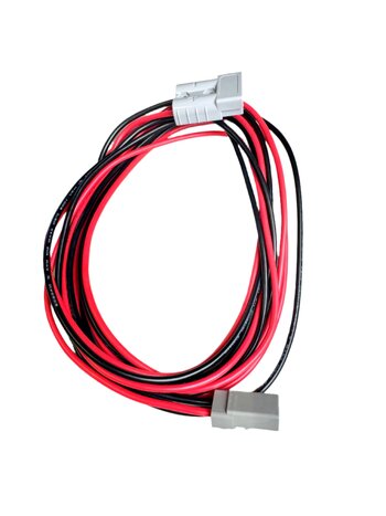

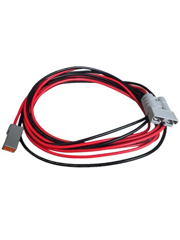

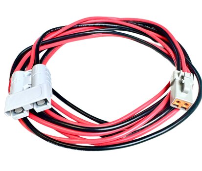

By popular demand, our 3 meter DTP to Anderson SB50 cable is now available. CLICK HERE
🔌 DTP-06-2S to Anderson SB50 Power Cable – 3 Meter
Power up with confidence using our 3-meter DTP-06-2S to Anderson SB50 Cable, engineered for rugged, high-current DC power applications in automotive, overland, and industrial environments.
This cable features a Durable Deutsch DTP-06-2S connector on one end, designed for sealed, secure two-pin connections up to 25 amps per contact, and a genuine Anderson SB50 SB connector on the other, ideal for quick-disconnect power systems up to 15A.
đź”§ Key Features:
  • Length:3 meters (approx. 10 ft)
    • Input: DTP-06-2S (Deutsch 2-pin, high-current sealed)
    • Output: Anderson SB50 (genderless quick-disconnect)
  • Wire Gauge: 12 AWG tinned copper for low resistance and high durability
  • Use Case: For use with INEOS Grenadier 15A DTP Power Port.
Built for performance in demanding field conditions, this cable is ready for expedition vehicles, off-grid systems, or mobile service rigs requiring reliable, field-replaceable connectors.
