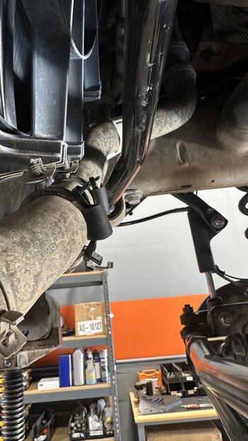

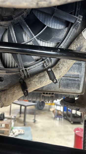

I’ve noticed with the US B58 motor the lower radiator hose can come out of the keepers. Two tie wraps and 2 1”x5/16” fuel hose and you can secure the hose a bit better.

Good fix. I’ll check mine.
