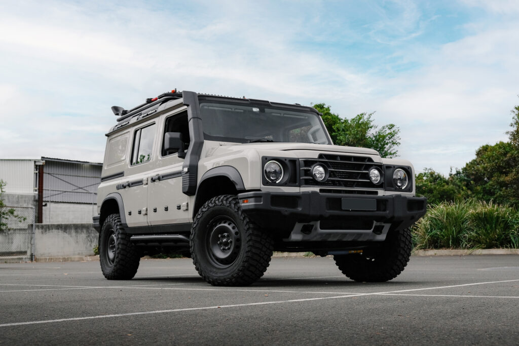

Does anyone have them fitted to a Grenadier? What is your feedback please. Please comment, if possible, on:
  1. on and offroad performance;
  2. towing a van.
I have only been able to find the B6 in Prados so far, with no decent review. Plus a vague AI summary
AI summary confirmed by someone who has had the Bilsten's fitted, as well as other brands.

The combination of the Bilstein dampener, Heasman wheel alignment, new Falken AT4 tyres, Bilstein B6 shocks, Polyair Suspension airbags and the EVCx X401 throttle controller have made the car a pleasure to drive. Wally has never driven better, despite the extra weight.
