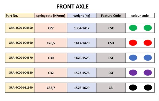

Here an old threads with all color codes. also depending on which markets:
Table above from a forum query in September 2023 from our beloved DCPU:
I hope this helps.
these are not the aftermarket lift kit springs correct?
yes, correct. These are the OEM ones from stock. However you can takes these values as reference and extrapolate.
