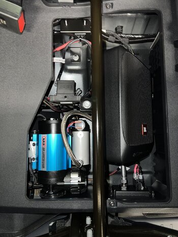

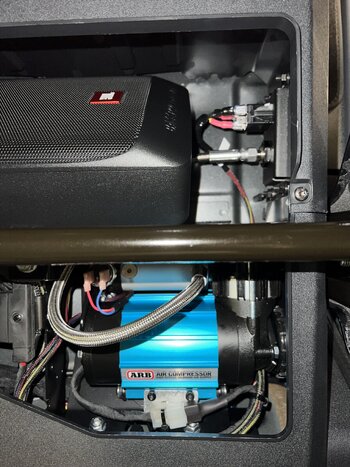

Maybe check with Agile I am fairly certain that's for a single compressor. They make an under seat option for dual (I just installed it's very easy) but you'd have to see if they would sell you just bracket and wiring harness if you want theirs. Owl on the other hand will sell you just bracket and you reuse the stock ARB harness but the wiring isn't quite as good as Agile option. Agile modifies the harness to include a relay and a trigger so you can only run the compressor when the engine is running.

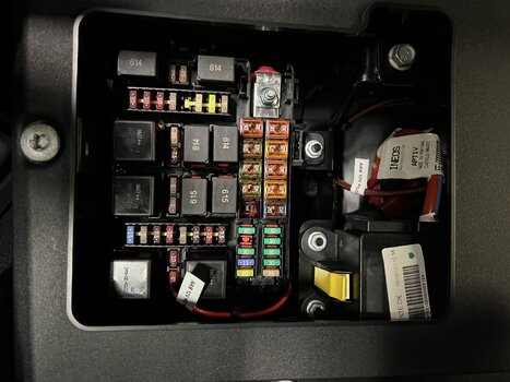

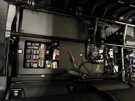

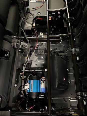

I recently installed an Agile on-board air compressor kit (Part #: AGA3001) under the rear seat of my Fieldmaster. My particular vehicle doesn’t have the secondary battery or additional “Littlefuse” bus bar box under the right rear seat so I thought I’d include some tips I learned during the install.
It seems the Agile kit is pre-wired primarily for the Trialmaster so if you are installing one on the Fieldmaster w/o the secondary battery you’ll need to extend the main 12V B+ lead to reach over to the drivers side “Littelfuse” bus bar. I did bring this difference up with Agile directly, and to their credit, they got back to me almost immediately and sent a complete wire extension I could splice into the loom to reach the drivers side bus bar.
I suspect they’ll modify their install instructions to account for some of the wiring differences between the Fieldmaster and Trialmaster and perhaps include an optional lead extension in the kit? The wiring is straight forward but I added some labels to the loom for future reference and if at some point another person is working on the vehicles wiring it’ll provide them with some breadcrumbs so-to-speak.

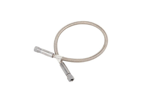

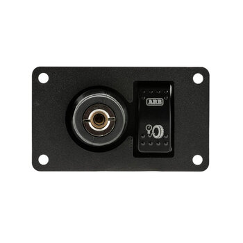

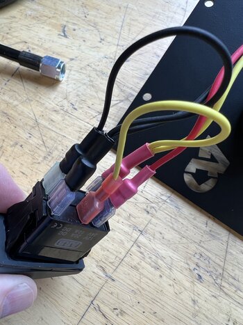

Other than the above wiring issue the installation was a breeze as the kit is very well thought out and everything is ready to go out of the box. I did modify my installation slightly and used a couple of parts from ARB accessories catalog (Universal Switch Mount and .5M stainless steel hose) to place the ARB power switch and air hose connection in a different location next to the air pump. I preferred ARB’s recessed design which protects the switch from accidentally being turned on and offers a little more protection for the air connection.
One last little learning, if you don’t want the ARB switch to be permanently backlit when the ignition key is on you can unplug the wire from “Pin 7” on the back of the switch so the switch only lights up when you actually switch it on. I preferred this switch configuration so if I see a light I know I’ve accidentally left it turned on as a reminder to turn it back off.
