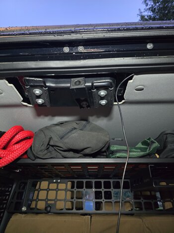

Has anyone pulled a cable down the middle of the headline from the switch panel to the door latch area? I would really like to run the cable down the middle for the rear Wolfbox camera and not around the side. I thought it would be a straight pass through but there seems to be obstructions... Feedback appreciated.

As someone who has installed the Wolfbox recently, why do you prefer to route down the middle? Just curious. Where did you mount the camera?

No real reason other than I thought it would be easier at first so mounted to rear camera in the normal spot on the back door and then routed the cable up and over to the center... then realized it wasn't as easy as I thought... but stuck with it and got it through. It really isn't any better than going around the side.
I didn't bother trying again. I just followed the space above the driver's side doors. Wouldn't have saved any cable length in the end. The standard kit was enough. Hardest bit was pulling camera cable through the existing grommet and tubing on back door. Don't know if I will get the mounting system, just using the bands for the moment.
