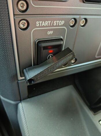

Hey all! Happened on a second hand 3d printer and figured i'd fab up something for the grenny. New to all this so no clue what I'm doing but it works in my car.
I designed and printed a button pusher b.c it seemed like a fun project and wasnt something I'd ever spend north of $50 on. Advantage is I am able to utilize the factory screw for it and it recesses into the factory screw hole (bottom left on a LHD Grenny).
Feel free to edit/remix, whatever but if you do, share the design...

I printed some but I don’t think they are working? To make it so that you don’t have to press the button every time, this should hold the bottom in the down position, right? When I printed it, it mounted find, but doesn’t seem to depress the button very far? Not enough to change the state or all the way down?? Am I understanding it right?
For me, I push the button with my finger till it engages then rotate over to hold the switch down. Mine holds the button fully depressed or close to it.
@MileHigh, here is a photo of mine. Is yours fully seated and recessed into the screw hole? If its not, it may not depress the button enough.
I reprinted it on a different printer. First one was PLA and a 0.6 nozzle, the second was PETG and .4 nozzle. I wonder if a slicing height difference was the change. I mic'd them up, and they seemed to be the same dimensions. I also used the lower left hole, instead of the lower right. It wasn't far off on the first one, but now it presses it firmly. Thanks for design!
Glad you got it working. Maybe the left v. the right hole have slightly different dimensions/screw lengths.
I don't know why, but the STL here didn't slice well in PRusaSlicer the round part was not continuous around the circumference, it would put a seam on it? Tried it set on Prusa Mini and Mk4, and wanted to do the same.
I re-did the part in TinkerCAD and after optimized the size for standard PrusasSlicer setting for a Mk4. Printed it off in PETG and it seems good. I tried to add some adjustability in it. I didn't figure it out until later, but the upper right screw is a lot longer and would easier to use as the pivot. It works, I might tweak it later to be a bit lower profile and print it out in Nylon so that I can make it thinner.
