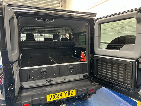

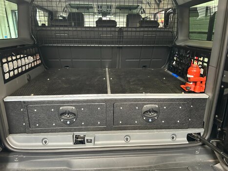

Not installed the grearmate installed from a UK company similar draw system, I was told the same real pain to install.
All I did was use the existing lash down eyes for 1"ratchet straps over the draw section ending the straps at the side which are under the cover section.
Then put a floor covering over the top. Due to the limited room I will not be able to undo the straps but if I ever need to remove I will just cut the webbing.
I even left my original flooring down, the draws are not going to move!
Unbolted the jack with bracket and relocated.
