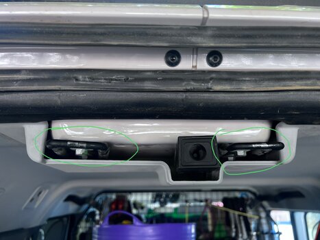

I had problems with my rear doors and not being able to lock the vehicle. I found I needed to adjust these catches out slightly. All sorted IMG_7223.jpeg

This is the issue i had, try closing it harder and see if the button no longer depresses. If it really bothers you, adjust the catches mentioned by logsplitter. I have been playing with these to see if i can reduce a boom noise from the door. The door will close with varying levels of tightness based on the catch position.
Thank you shiv I am now having no issues when using the standard button pressing lock method, but now that a few have mentioned the adjustment option at the rear door catches I will look at this further . 😁👍🏼
