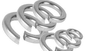

If they are on and have spring washers[Photo]keep on eye on them, but if not yet fitted it is always a good idea to put thread lock on (y)
