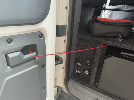

We had been seeing intermittent issues with the lock, however only with one key - so I am hoping that the gods of intermittent faults will cast the dice in our favour, allowing me to implement a mechanical fix in case it happens again. I’m thinking to drill a hole in the handle and attach some ripcord so that it might be activated despite the obstruction of the drawer system/fridge.

If anyone is heading truly remote with a fully packed loadspace a little mod might be in order. I’ll email GrenadierUSA later today to see if they’re interested in fabricating a replacement (billet?) handle that would make a better emergency release.

As hoped, we were blessed by the chaotic neutral intermittent fault. Open sesame!
Have installed a failsafe of sorts:
