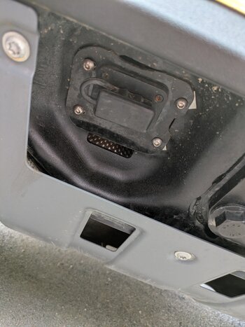

A not very exciting picture of the Anderson with rubber cover on the rear.

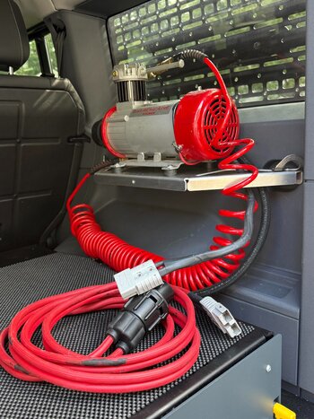

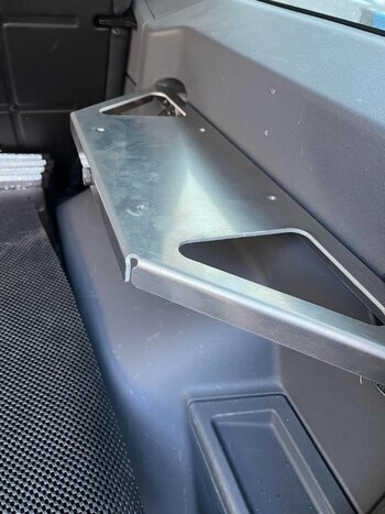

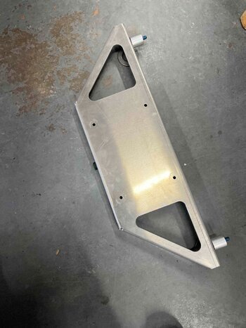

I had a local machine shop build me an aluminum shelf that I mounted in the rear. I was very impressed with how strong the mount points are. It works very well.
