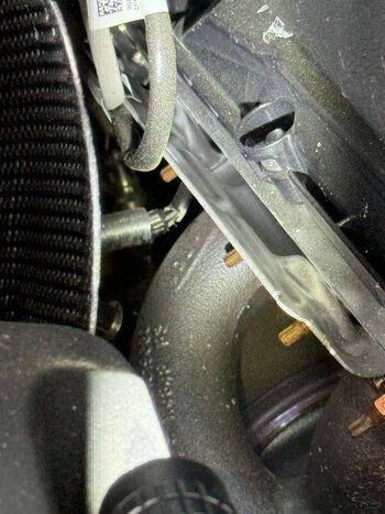

Problem found, O2 sensor harness was lying on the exhaust manifold. Pulled it away and cleared codes, all good. Now to the dealer to fix. Nice QA Ineos lol
Best I can do, I'm not near it now
