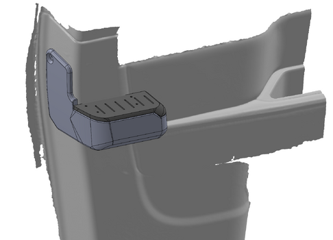

One of the first things I noticed when I started daily driving the Grenadier was the lack of a door-mounted armrest. I find that good elbow support makes one-handed driving much more comfortable for long stints behind the wheel. The generous flat door top surface is great but I missed a door-side arm rest that mirrors the center console.
This is not a big deal of course, but if you are prone to multi-week trips you have lots of time to ponder these details. Anything that reduces driver fatigue is a win, and lots of vehicles get this detail right. Even my Jeep Wrangler, for all its shortcomings, had perfectly matched elbow support on both sides.
I stared at the door card for months trying to figure out how to attach an armrest that would mimic the shape and position of the center console. It's not an easy task in the Grenadier, and unfortunately the method I landed on is probably not acceptable to the resale-conscious masses.
I laser scanned this area of the door so that I could conform my design accurately to the curved sheet metal of the door structure. You see, nothing is as flat or square as it might appear with the Grenadier. I have been shocked to learn that virtually every old-school straight line on the vehicle is not, in fact, straight. The flat faces of the sides are not flat, but slightly curved. Even some of the console rectangles are actually trapezoids.
A few quick prototype iterations allowed me to match the console shape and fit properly to the door surfaces. This armrest must avoid interference with the door seal and also provide clearance for the seatbelt as it passes between the seat and door.
View attachment 7897640 View attachment 7897634
