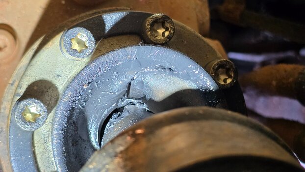

I went with the 2.5, installed properly, at a reputable shop. I watched the CV joints for about a month with no problems. It's currently at the dealer getting its first service, and they sent me a pic of my split-open boot. I had not inspected it after going off-road the last time, so I'm guessing that's when it occurred.
My question is, has anyone had shaft problems with the 1.7 front lift? I have searched and have not found anyone so far who has had problems with the 1.7 installed. I'll go to 1.7 if it eliminates the problem, but if the problem still exists at 1.7, I might as well leave it where it is.
Thanks

The more I dive deep into this, I think the conclusion is the boot itself being a problem. I have the 2.5 boot doing fine still been 6k miles and off roading A lot even Moab once. So far so good.

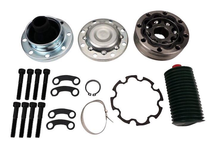

Sadly the boot is not replaceable on the stock joint, but it is on the Terra joint. You just have to catch it before you eat up the joint.
I’ll add this link to a less expensive CV. Don’t know if it is as good as the Terraflex one but I’ll venture it is the same as OEM.
