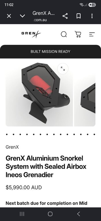

This looks like the external snorkel, a seal and part of the internal pipe inside the fender and the bolt holes appear to match between all three components.
@LazarusTheGrenny can probably tell you how they go together, but the OEM schematics in the thread give some idea.
Thanks for the pictures. I've never seen this view of the back before. This is a design as it should be: two flanges with a rubber gasket in the middle and six screws around the perimeter firmly connecting the two parts, ensuring a tight seal. The metal construction also has the advantage of being less prone to bending. Perfect. (y) (y) (y) :)
utilising the original panel entry and running lamp also give it a big tick. personally i would put loctite 5xx gasket eliminator on the mating surface as well for extra insurance.

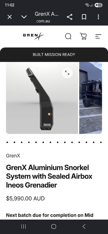

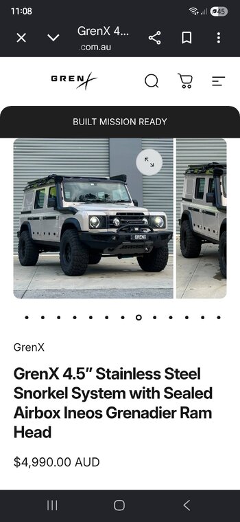

. Have 2 types of sealed snorkles.
The round GrenX snorkel has two variants, ram head and back facing tear drop style, making 3 in total.
Rear teardrop variant has the loudest induction noise, the ram head is quieter and the GrenX OEM style is the quietest of the three choices.
