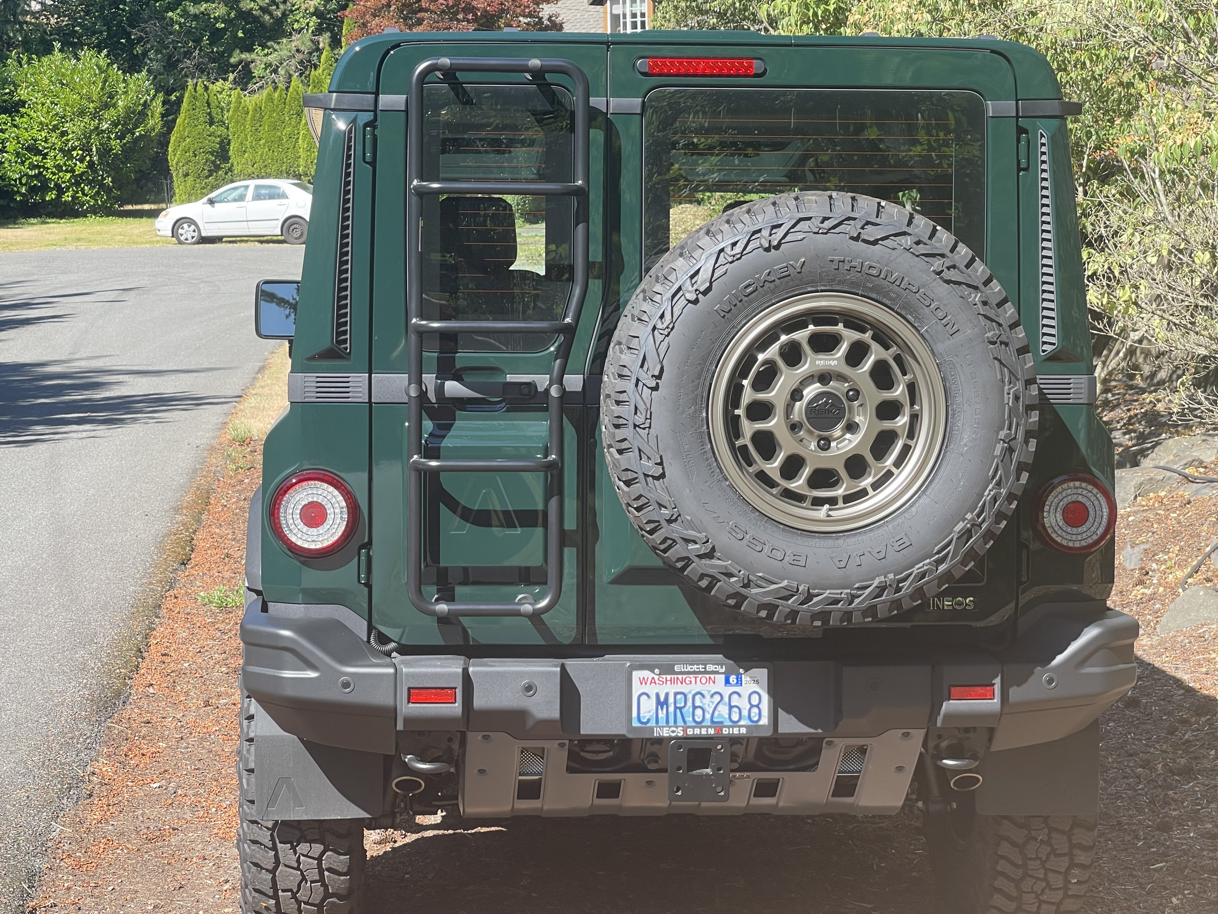

I just went with 255/85R17 Mickey Thompson Baja Bass AT’s on Reika F35’s and it’s 1/4 to 3/8” too big. I can open the little door but I have to open the big door from the inside. Guess I’ll be buying the bracket. Also this is stock height. After the Eibach lift springs are installed it’ll balance out, but 255/80s or some other combination that gets you below 33 to 33.5 max diameter should be fine.

You mean you have to crawl through the inside to open it? I love that look it’s perfect but I use that door every single day I can’t be crawling through.

I just went with 255/85R17 Mickey Thompson Baja Bass AT’s on Reika F35’s and it’s 1/4 to 3/8” too big. I can open the little door but I have to open the big door from the inside. Guess I’ll be buying the bracket. Also this is stock height. After the Eibach lift springs are installed it’ll balance out, but 255/80s or some other combination that gets you below 33 to 33.5 max diameter should be fine.View attachment 7862057
Looking on MTs website it says those are 34.6”. 255/85r17 should be 34.07. Do you think a half inch smaller tire would allow the door to open?
So to answer a previous question, yes a one size smaller sidewall would allow the door to close. Mine are 255/85s and 255/80 would work if you can find them.
My solution was to get the Agile Off Road spare tire relocation bracket. It allowed me to open the doors easily and turn the spare face out. It bolts onto the existing mount it doesn’t replace it. I don’t know how it would at Dakar but it’s fine for my needs.

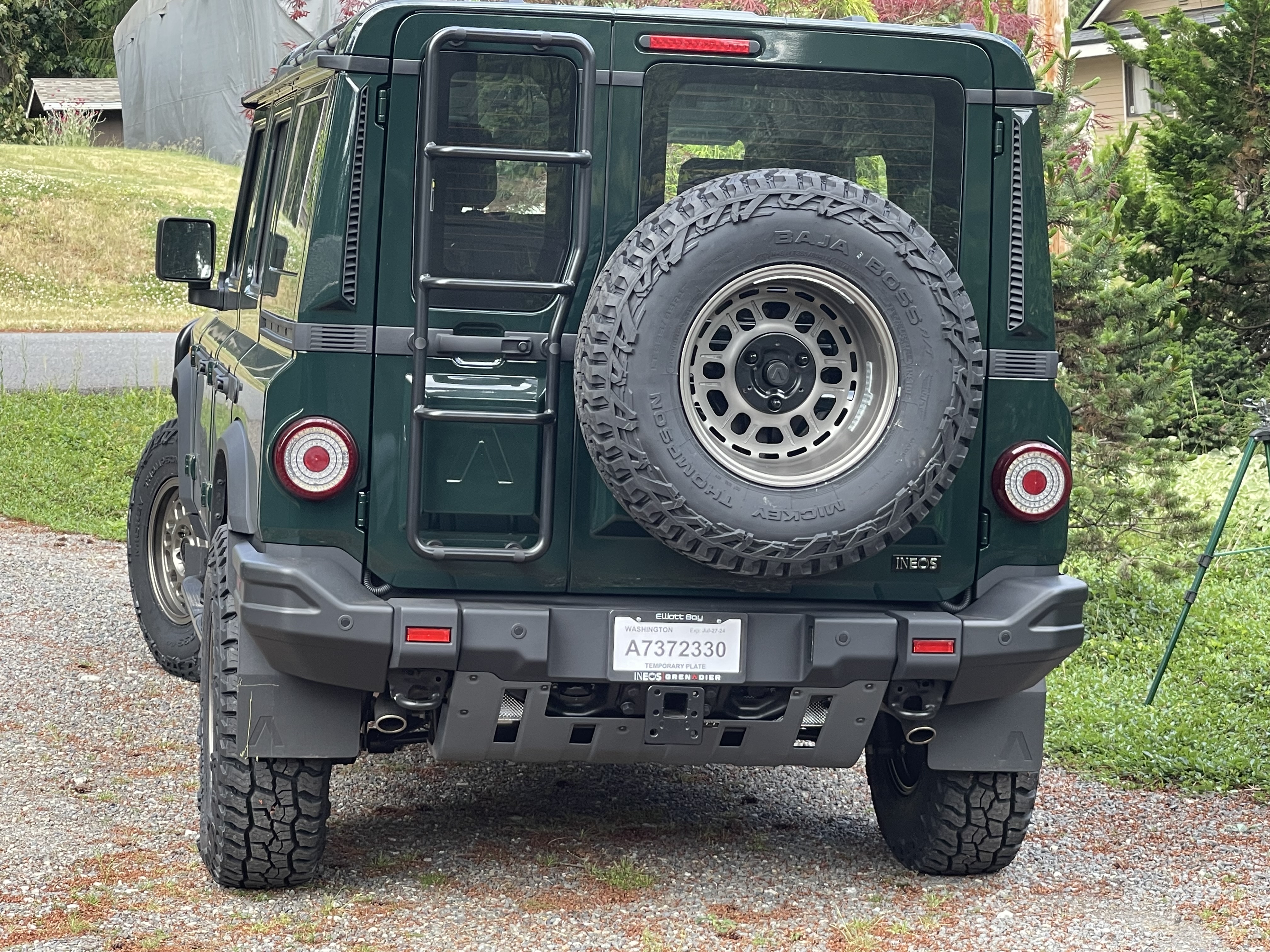

So this is with the Eibach lift springs for vehicles with winches.
